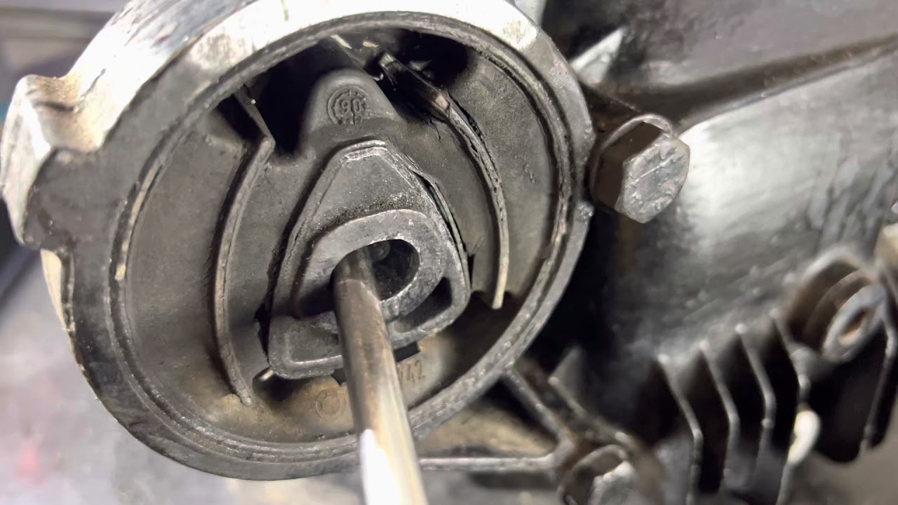

    The differential has been sqeaking and nods up and down under load so it was time to get some new bushes.

    Here's a small video clip of the rear diff bush on video which shows the seperation:

    The rear bush – the middle part is separating from the outer part leading to excessive movement.
