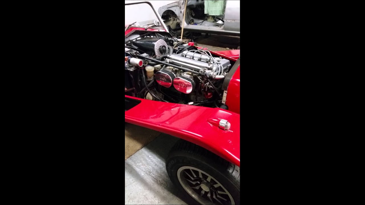

                    I saw this on Youtube and thought of you. I little bit of inspiration for you.
                    https://youtu.be/NRbLafpjmu
                    Mk2 SWB Marina Roadster with a 1800 Fiat Twin Cam engine and 5 speed Abarth gearbox built in 1987

                      Wow wonder where that was taken ??? there cannot be many Marlins with an Alfa engine and the spare wheel in the front right hand wing - could be my original car !!!
